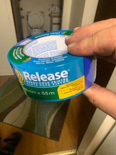

I was printing a model on my CRM4 that started well. The raft was printed but then when I left the print for nine hours I came home to this. My bed is 65 degrees and I applied glue stick on the bed. Should I use blue tape on my bed? I put a layer of blue tape down but will this help?
I had a failed print with the blue painters tape. The print slid off the bed. Here are the two photos. The bed temp was 65 degrees. The nozzle was 210 degrees. The print failed still. What am I doing wrong? Is my temp too high for the blue painters tape?
Should I be using a brim or a raft for my printer on the CRM4 with blue painters tape? Should I lower the temp of the build plate?

If you use glue then tape is over kill. It looks like you are using a PEI sheet on the bed, if so try printing without anything else.
I am trying with just blue painters tape. The glue stick doesn’t work. The PEI sheet is too slippery. It is not like the K1Max PEI.

I applied uhu glue stick to the top of the blue painters tape.
