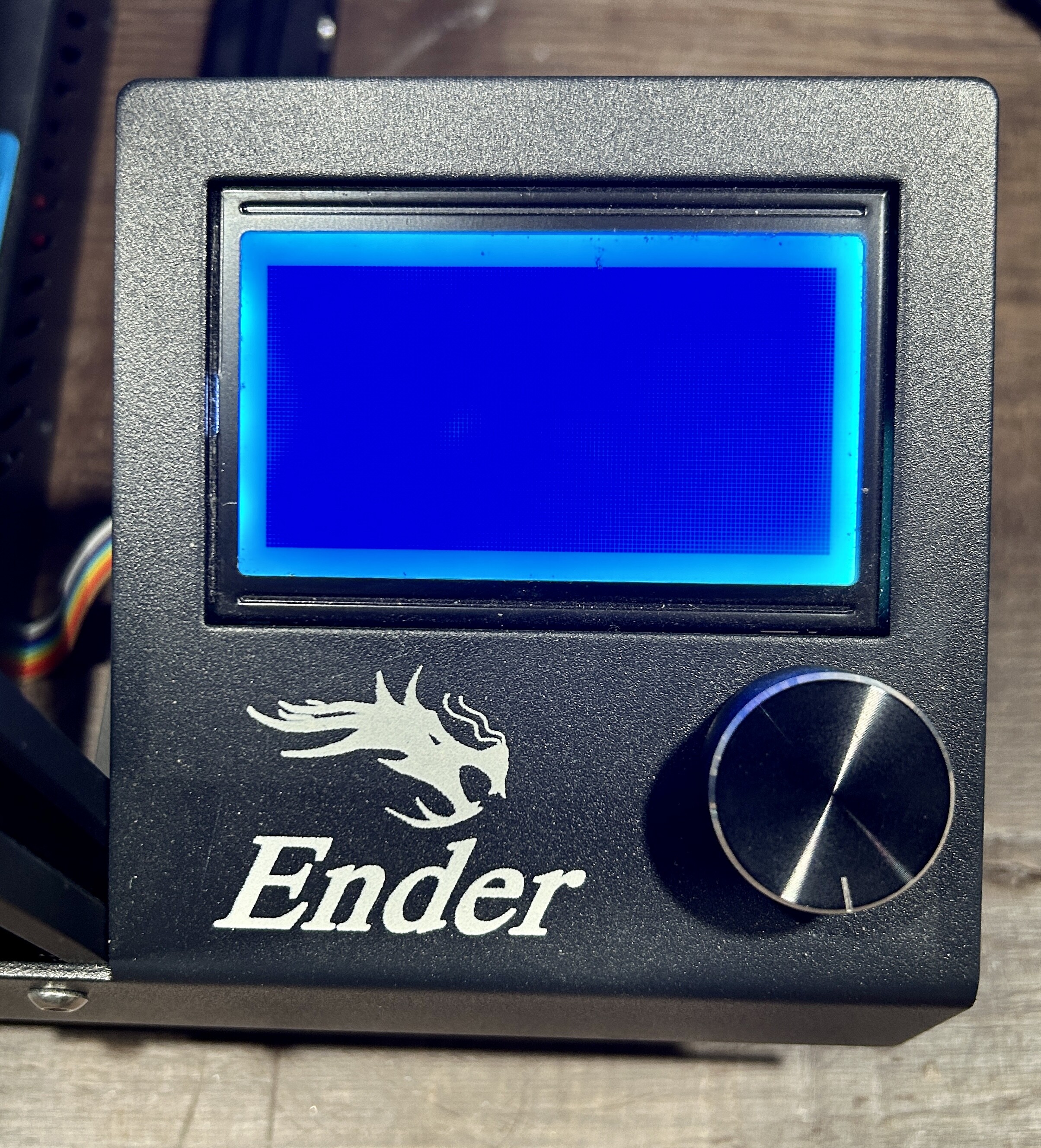

Hi everyone, I have a Ender 5 Pro for a couple of years now. It has been working great until yesterday. I concluded a small print about a week with no issues. I loaded up the printer yesterday and was hit with the no display issue (lights up, but no characters) and hoping the hive mind can help me out.

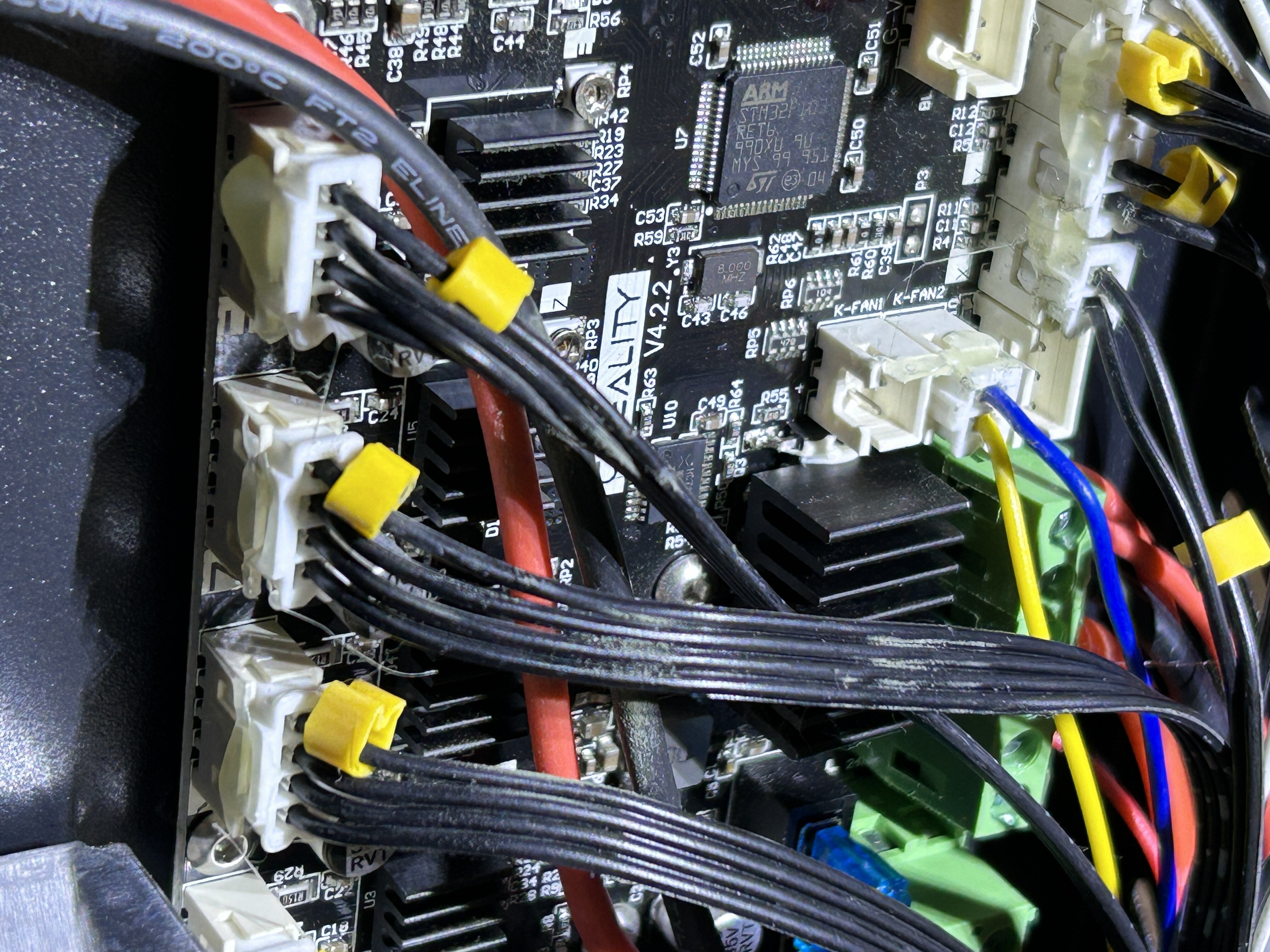

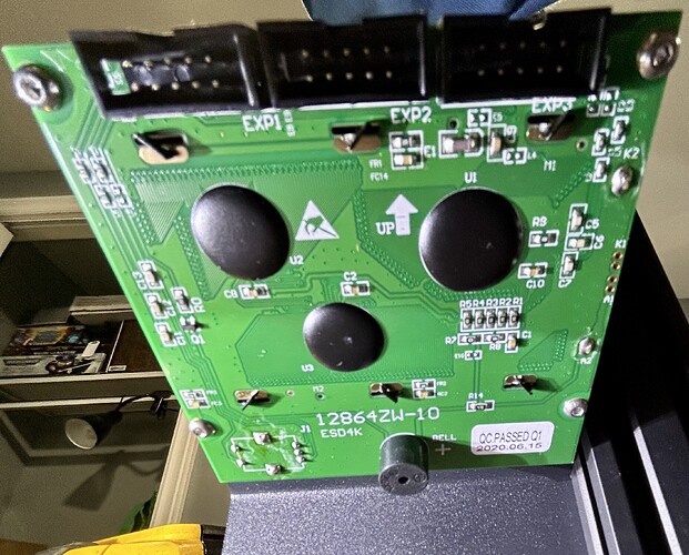

Reseated all cables to the display and the main controller board.

If you exhaust all other potential problems and there isn’t an obvious fault then it has to be an electronic problem. Either the motherboard or the display has gone facockta.

Do you have a screen from another printer that you know works? If so you may want to try to plug it into your current printer to see if that works for you.

I suspect your problem is with your controller board (what you’re calling a “motherboard”). Without more information (ie what controller board you have) there really is no way to help you debug exactly what’s happening.
As you are seeing the USB serial port, I believe the controller board has a serial to USB interface chip (ie no USB built into the MCU on the controller board) and that is why you’re seeing the port in device manager.

Thank you for the reply. I’m pretty sure its my control board. I joined up with a local 3D printer group and was able to get a LCD to test and received the same results. I tried updating the firmware with an SD within the printer but nothing happens. I downloaded Ponterface. COM3 appears in device manager, however when I try to connect with Ponterface all I get is “connecting…” and it doesn’t go any further. With Cura or the Creality slicer, I couldn’t connect to the printer at all. I think the control board is the only option now.
