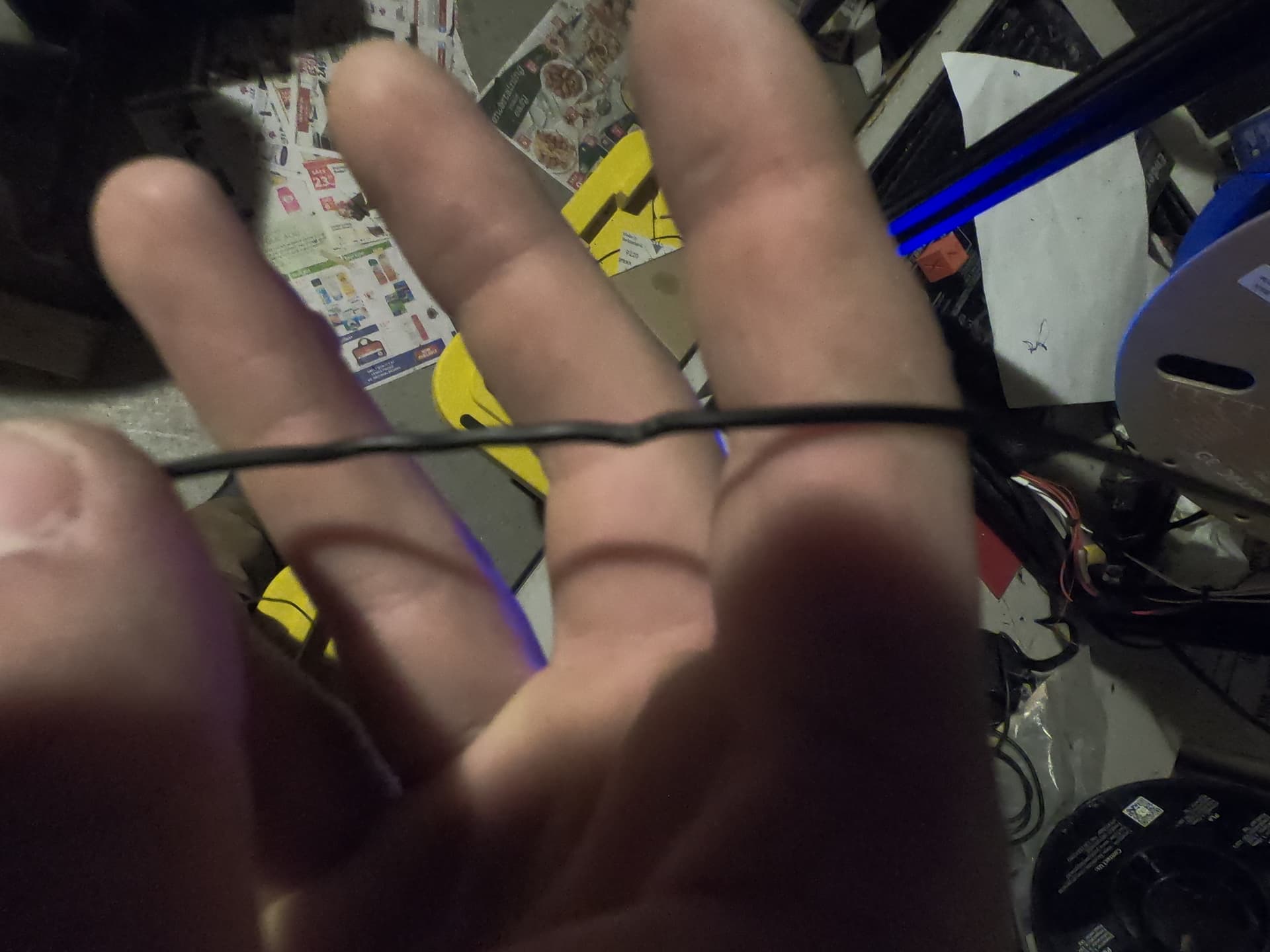

sorry new update I had another failure and looked at all the ends I had cut off and noticed a consistent bend in the filament where it had stopped at the drive wheel and bent around it not sure why it is stopping during print as when I was cleaning the print bed it went fine moving every few minutes

the pla cube came out good but it didnt print the tpu, noticed that on all the pieces i cut off that their is a bend where it stoped on the drive wheel retracts but wont advance

turned out i wasnt pushing the tube all the way down and as a result it was backing up and clogging the nozzle
