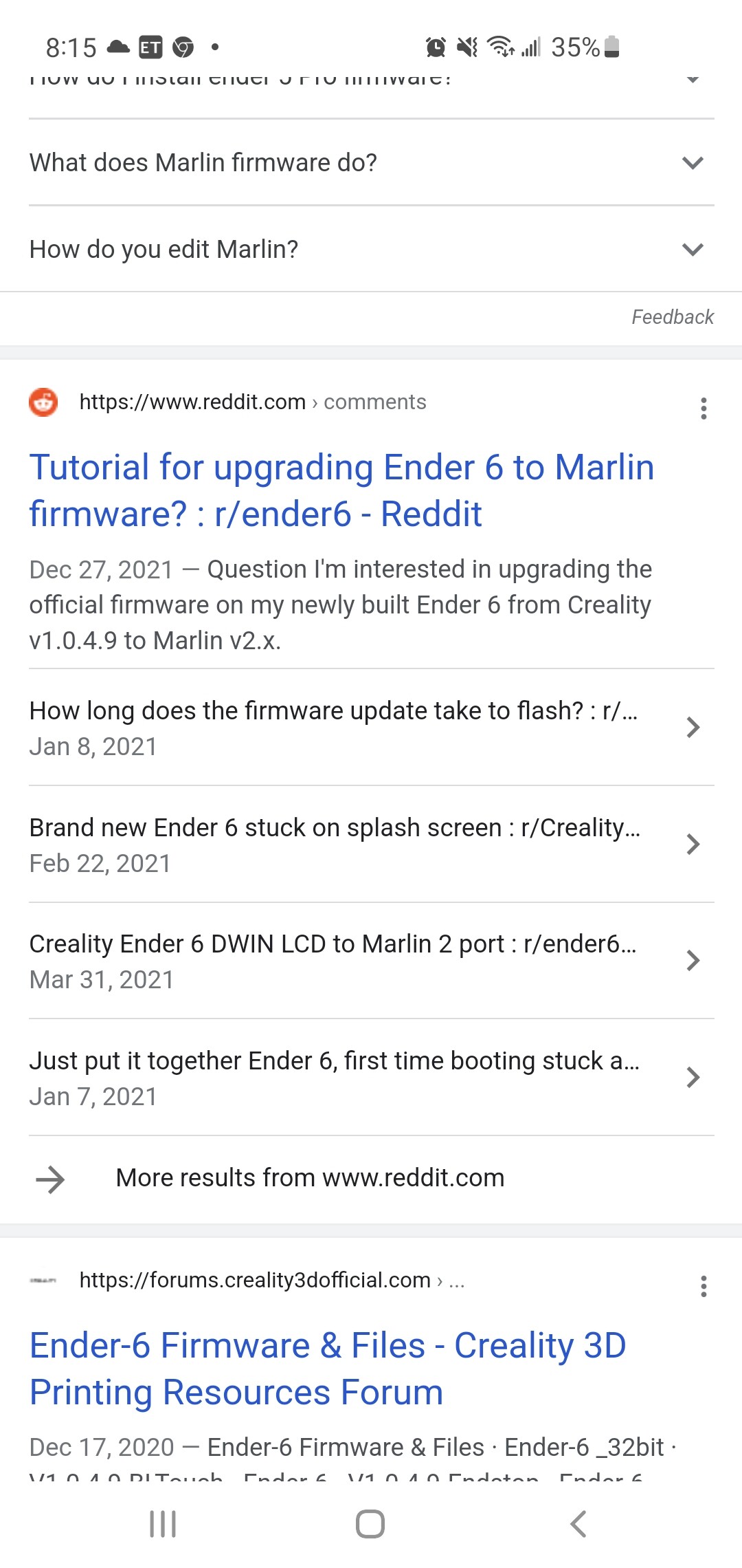

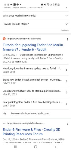

After lots of searching, I followed a tutorial found on reddit, and it fixed one of my issues. (Still cant spiralize or vase mode)
It’s free, but complicated. Read everything including the comments. You’ll need a micro SD to flash the screen, which you get to completely disassemble to access.
I followed the directions perfectly, and still managed to install firmware for dual extruders.
I’m not recommending this approach, but honestly there isn’t a lot out there without parting with significant money.
