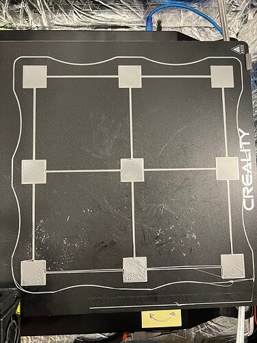

I’ve been having some weird issues lately that I can’t seem to address. I’ve trimmed the bed, adjusted the z offset, and re-squared the x gantry. When I do a first layer test the left side of the bed prints like it’s too low. The bed visualization in octoprint looks like it’s pretty damn close and even if I raise the left side it still seems to print like crap on that side. Here is an example:

Also is that the build tac plate? Perhaps its time to change that to some new build tac, or i just went to a magnetic steel sheet. You may be able to test my theory by putting a bed adhesive like glue or hair spray down on the left side there and see if it helps.
Haven’t changed the nozzle or anything else for that matter. Started using PrusaSlicer but that’s about it. Occasionally when I run through the ABL process it looks like the bed drops off at a 45 degree angle about an inch or two from the end. It was making me wonder if there could be BLTouch issues.

been there done that … this may be basic thing to check but try cleaning bed with isopropyl alcohol. finger prints are a royal silent print killer. also I went through several creality magnetic bed until I switch pei. noticed you image have dirty or ware at that end.
Looks like every square but maybe one is too close to the bed. Those ripples and separations aren’t from being out of level, but from printing a few hundredths too close.

No I don’t think it is. In fact it’s pretty damn flat as far as I can tell. I was more thinking about ease of print removal (been considering it for a while). But I want to figure out these issues before I buy anything new.
