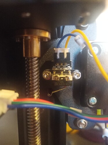

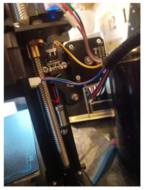

Good catch. The touch hangs off the side of the extruder housing on the B1. Definitely not there. I saw ABL ENABLED, and then your photo, and made the wrong assumption. My apologies to all.

Look lower down, near the level of the bed. Itâs just a screw stuck onto the aluminum extrusion.
That screw head is what triggers the limit switch and has to be higher than the bed. Can be any height above, then tune electronically with the z-offset.
you can do home and see if itâs working by triggering the switch with your finger. if it is then the next thing is to make sure it stops on the switch before the nozzle hits the bed. adjust it with the screw
No the switch doesnât seem to work at all unfortunately I donât know weâre to go from here lol maybe Iâll have to buy a replacement wire or switch unsure

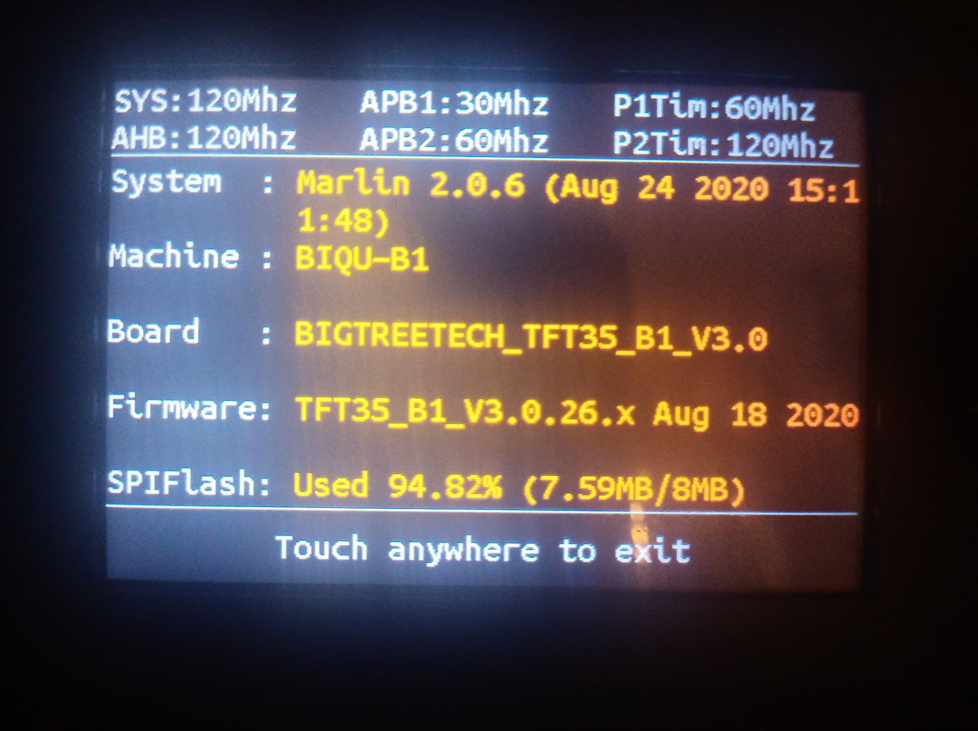

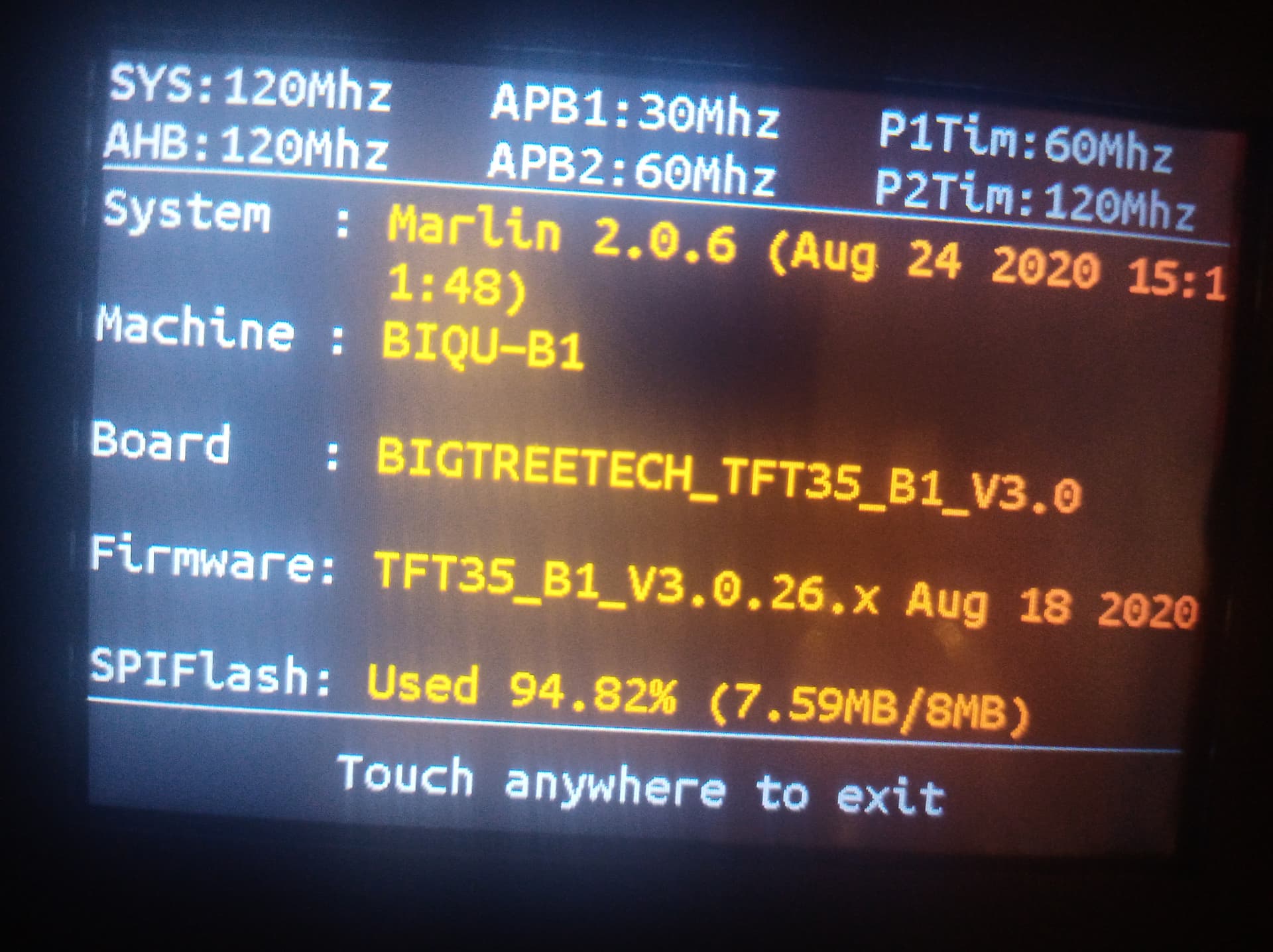

someone could have changed to firmware to expect sensorless Z homing. in the touch, screen menu go to menu setting info and post a photo here of that screen

looks like the original firmware that came with it. there were some small issues but should work. Do you have any way to test that switch?
To be sure, take a switch that is working, and move it & the wire harness to the z.
Then you will know.

Iâve tested with my finger didnât work
