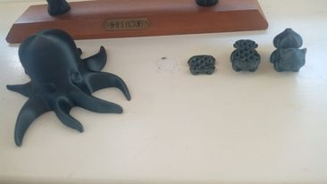

I’ll send a pic of the finally print
Came off the bed plate was so close thou lol few fail

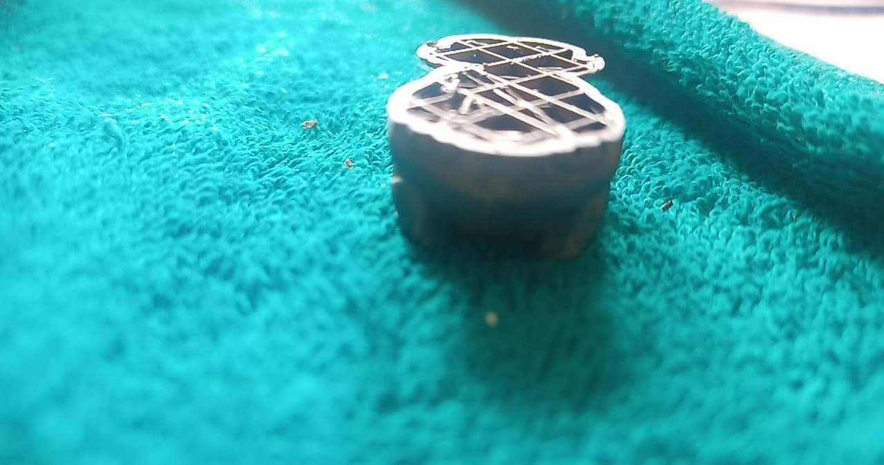

ahh, thats too bad but what does the bottom look like? that first layer is very important. Also, the plate has to be very clean, like it’s about to get a vaccination clean and not touched with hands.

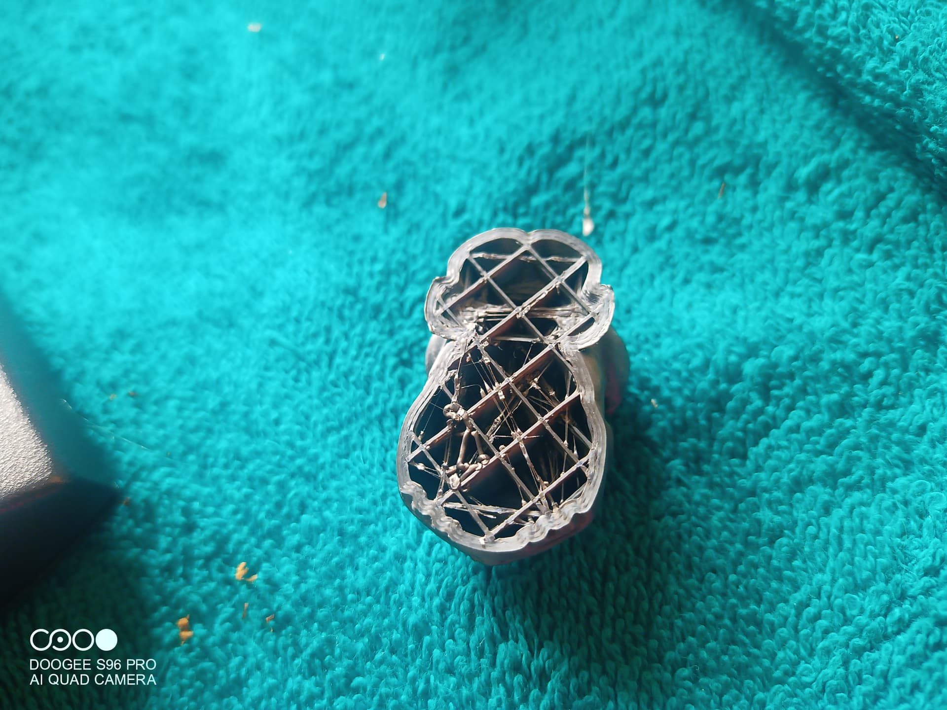

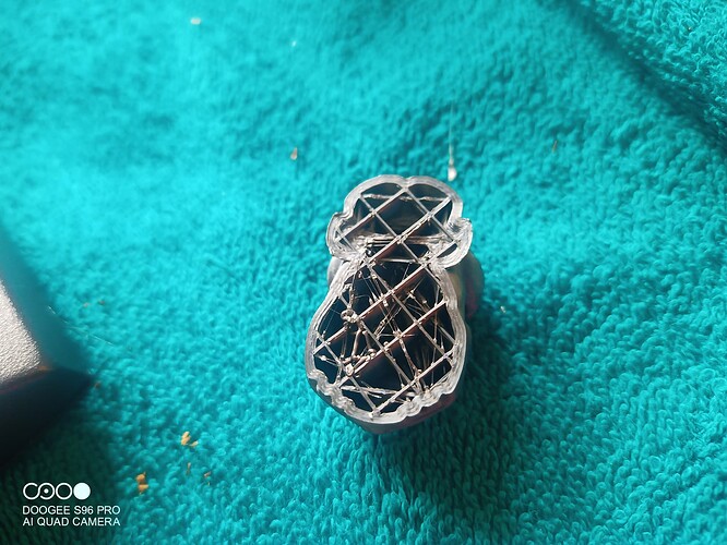

well ive made theses think i have it down need a clean now should i leave brakes inbetween prints? heres the pics
Time breaks you mean? not necessarily. mine go from print to print and never had trouble but I don’t stop to clean the build plate off when it’s busy. PLA is fine usually but If I have something I know is going to be a sticking problem then I take the plate off and give it a fine mist of hairspray. usually, that keeps things sticking for a dozen prints clean or not. I can’t really see detail on the bottom of that print in your photo

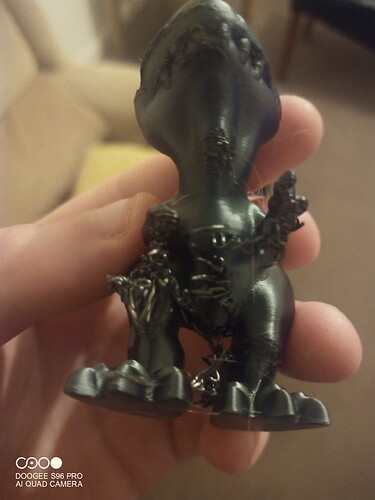

Thanks I will have had few problems think at leveling the bed or could it be something else
That looks like too much overhang with no support. What does it look like in the slicer?
