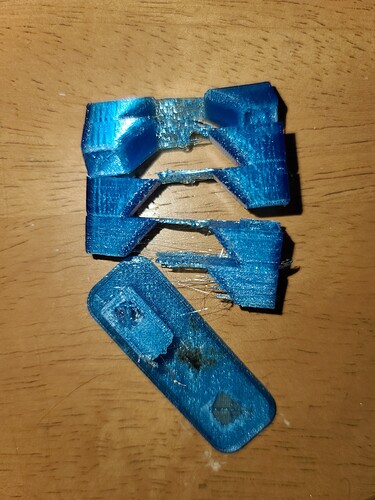

House brand PETG issue?
Weak and brittle prints with house brand PETG
4 walls, top/bottom/sides
20% infill
225c 80bed
Two different colours both fail and split along layer lines and perpendicular on two different printers.
If I print the same parts in PLA they are stronger, is it me the machines or the material? ( I bought like 8 different colour spools and the two I’ve tried have given me the same problems… )

if you bend it where does it break ?
