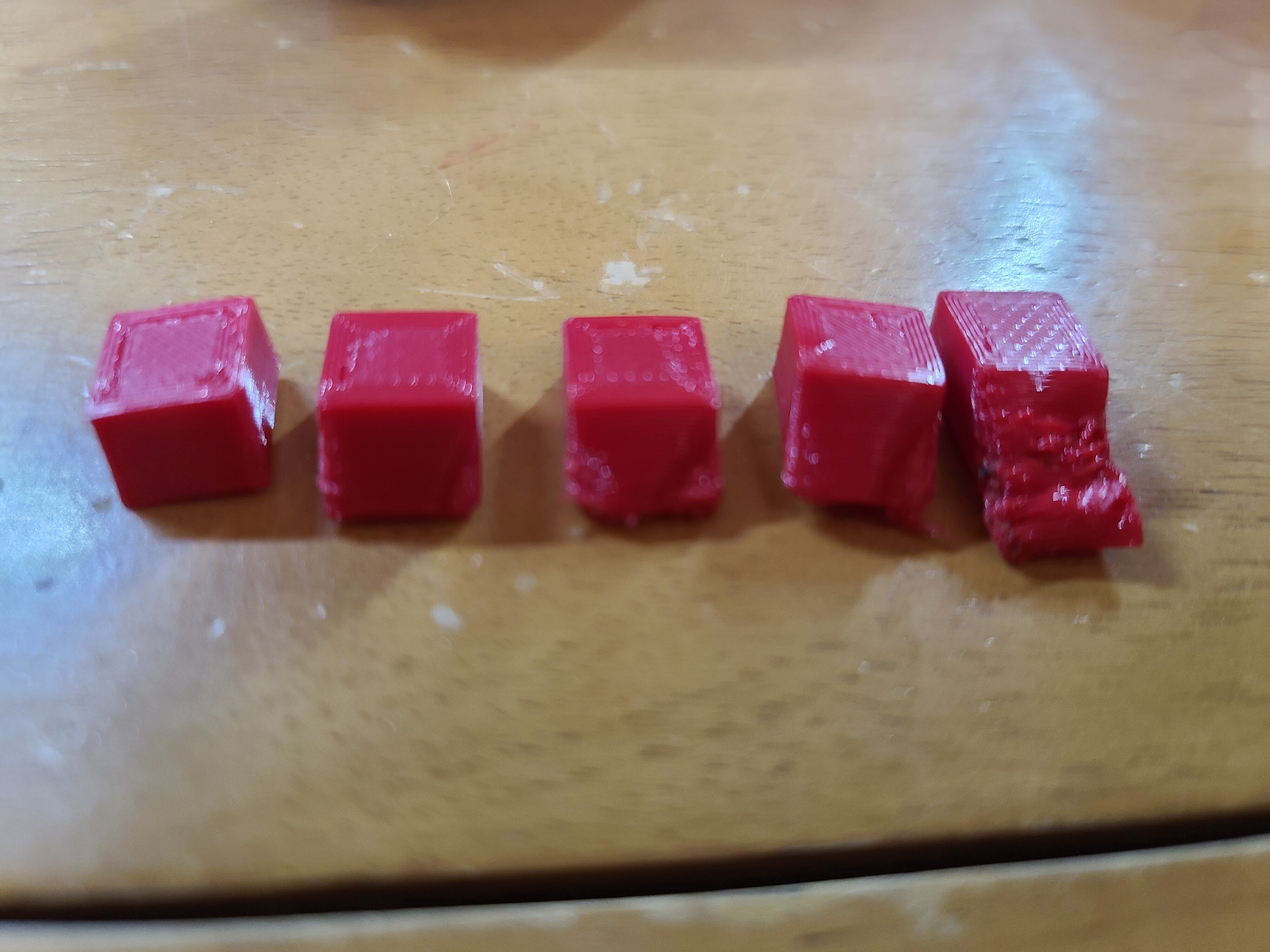

What does this tell us? EDIT: after looking at some of the makes it looks like i need to recalibrate my e-steps as a start, i did it once but have since flashed new firmware so i think it needs to be done again
I had to enable print thin walls for it to slice
I did the TeachingTech version it turned out as expected even after a poor first layer
On my printer, a new firmware update brought a new tuning menu option for setting e-steps so it’s dead easy. basically measure, mark, press the button, measure again, and enter the new value. I printed with 3 filaments today, one PLA one PTEG, and one PTEG with carbon fiber. all f it was 3dPc material and each one needed a different e-steps value. I thought it was set once in a while but it appears there’s an advantage to set it for every kind of filament.

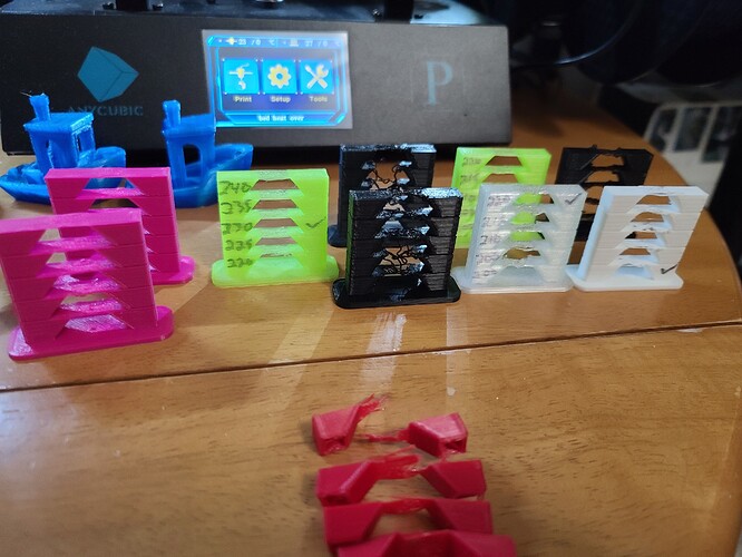

I had done temp towers before and settled on 235° for the PETG filament. your test cubes look better than the first prints you showed this morning.

it’s breaking both directions.
Fresh temp tower 250-210
I can’t break these pla towers this easy…
Only the pink is PETG is the above photo
Clear is Eryone
White is Polymaker
Black is Polymaker, Eryone or Overture
Green is mg chemicals
Pink is the one shown a few posts up
I’ve used this much of each roll trying to make it work… :frowning_face:

Even tho these failed ( on 3 attempts with a clean level bed ), running with no fan just smart bridging the edges are unacceptable. I just want aesthetically pleasing stronger than PLA parts, is that to much to ask?
Here are transparent red and white PETG test cubes ive printed recently. The red and black carbon fibre i have (cubes in the shop) has absolutely got to be dried before I print it. The white I dont think I’ve ever dried and didn’t have trouble but that red is a problem unless it spends time in the dryer first. The shelter thing I’ve printed 5 or 6 of them coarse and fast and they come out ok (we have lots of eggs from our chickens) still need 6 more and have no time heh.
oh and those cubes are solid. The red is very friable if I don’t dry it and the carbon fibre I posted the video of jams up the nozzle.

the thin wall boxes and cubes do look like under extrustion. Because they are brittle I am tending to lean that way.
What were the results of the extrusion calibration ? if the e-steps are ok there I’m almost thinking the nozzle may be partially clogged?
esteps went from 415 to 433.31 the teaching tech cube was after re calibration
