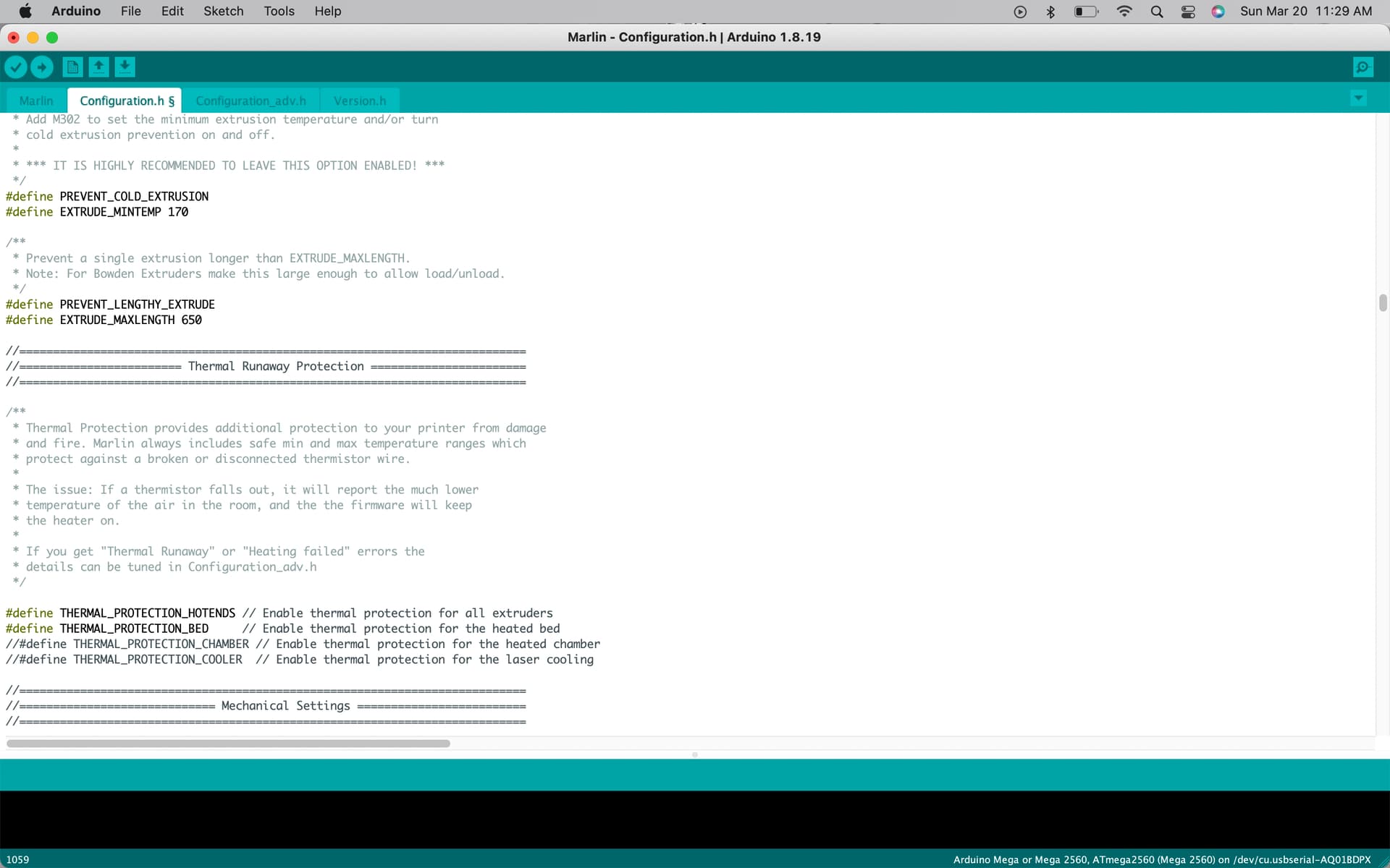

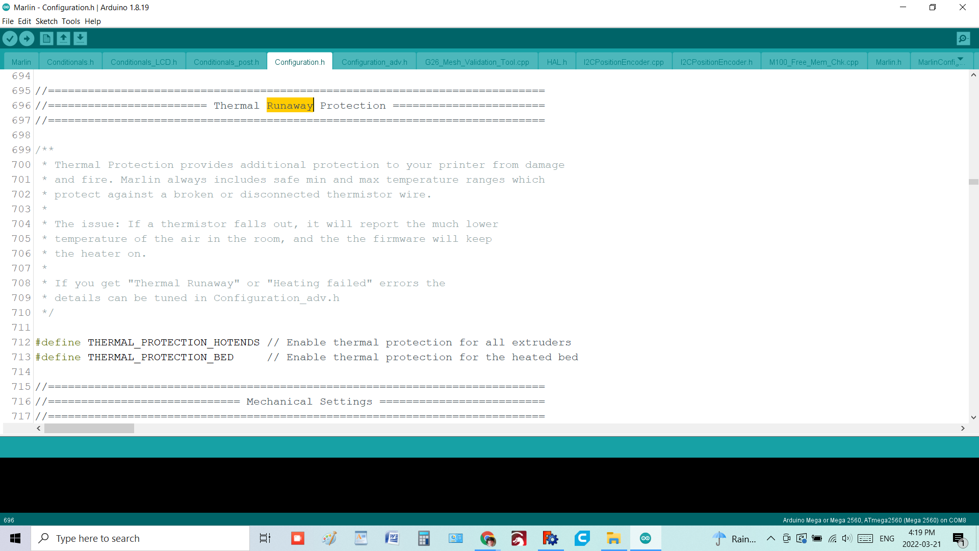

go down until ya find thermal runaway protection. and find where it says chamber and put // in-front of it.
next go to cooler and put // in-front of it.
There is no line with chamber or cooler.
i will copy and paste after work
If it’s not there wouldn’t that be the same as // ?
the // makes it mean nothing without the // it will be part of the firmware you load to the printer.

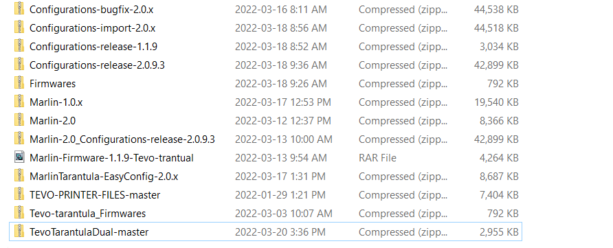

I’ve tried ALL Of these
Some have just the 2 configuration files and Adruino won’t open them, and I’m not sure how to
do those, unless I replace the same 2 in another Marlin file.

click on the link i posted, then lick ‘‘code’’ and thats where it will say “Download zip” and then follow the yt video.
I tried to find it with 0 luck.
I’m just trying to find any that will load.
