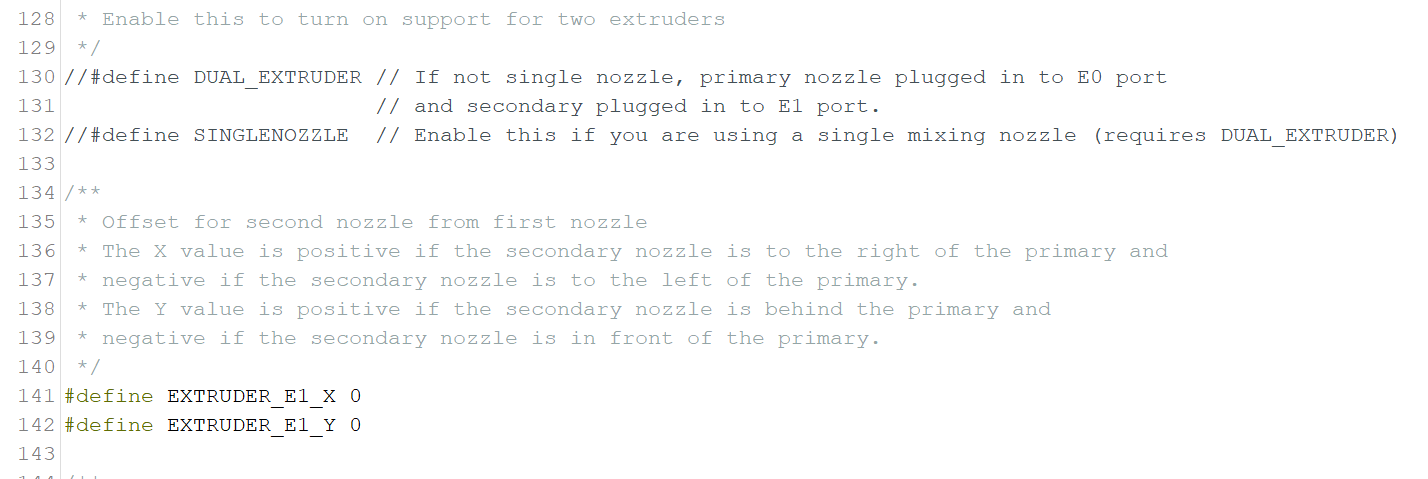

I’m looking through the config file in MarlinTarantula-EasyConfig-1.1.x Before in load it,
where it // for duel extruders I Assume the following lines referring to it don’t need the // before them
leave it unless its dual
Thought so, just wanted to make sure lol

Just loaded …MarlinTarantula-EasyConfig-1.1.x…
preheated pla (nozzle / bed), took a bit too long before starting print… Got the same error
Heating failure E1
Was the problem the duel extruder firmware?!?!?!

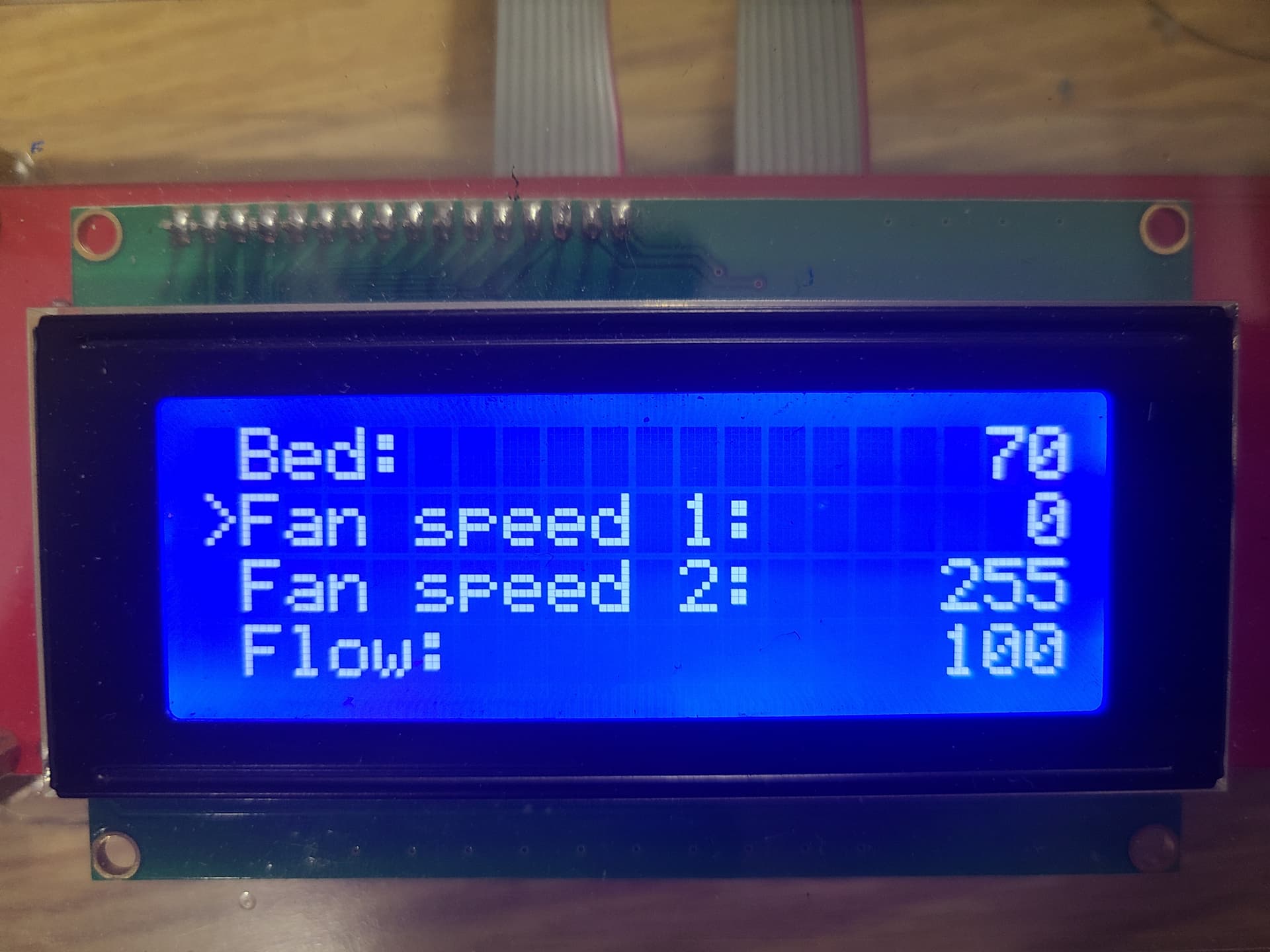

Top fan… on with power

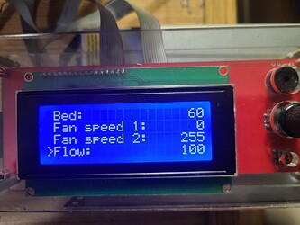

Bottom hotend fan …only comes on when I tune and turn it up.
Fan 2 in bottom pic goes to 255 just as it starts to print.

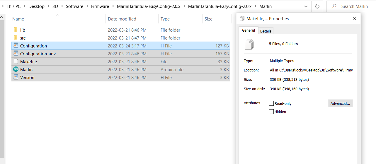

Checked through both config files (.h and _adv.h) (MarlinTarantula-EasyConfig-1.1.x)
Found nothing that I Understood as to the control of 1 or 2

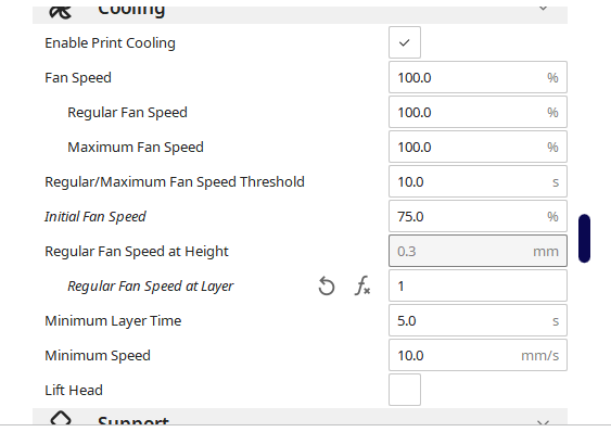

Not even in Ultimaker Cura 4.12.1
it seems to be wired wrong, the top fan should come on when tuned and the bottom fan should always be on. that might be the other issue with strings and the filament problems.
, edit that is way to small to read. I will send you a video or picture of what is done to my tarantula.
as soon as I read that I thought the same thing, your fan on the hot end cooling tower should be on all the time unless it’s enabled under thermostat control in which case it should come on automatically after the hot end reaches say 50 Deg. you should have NO control to be able to turn this fan off.
The part cooling fan (blower fan) is the one you can adjust, ON for PLA, OFF for PETG, so on and so forth.
If your fan control is messing with the cooling tower fan it’s wired up incorrectly or the firmware is pointing to the wrong pins.

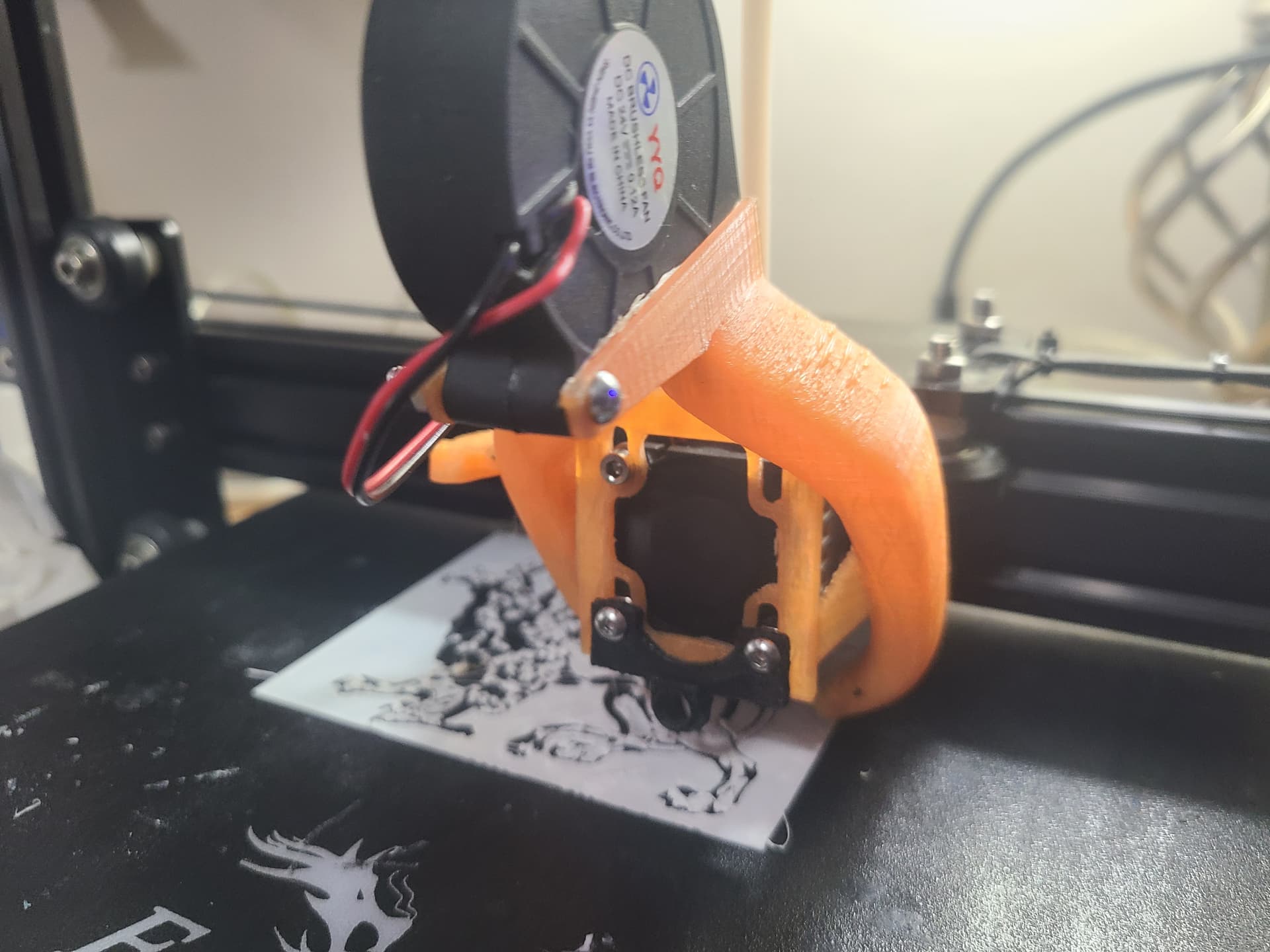

I printed and added the part fan and wired it direct the power supply. Haven’t added the
switch yet since I’ve only printed Pla so far.

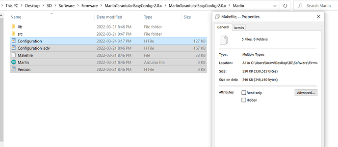

If I could find out where (I’ve looked in both the config files from line 1 to 2320 (.H)
1717 (adv.h)) it is in the firmware I would fix it.
I’ve probably Seen it… just didn’t understand it
Hot end fan is wired to
With the firmware for your Tarantula are there a fist full of files or just the config ones.
Which firmware did you you use and did you edit it much for your Tarantula?
I Assume the fan controls lines are in the config files!
In MarlinTarantula-EasyConfig-1.1.x
In MarlinTarantula-EasyConfig-2.0.x

Sounds like the firmware is doing what it’s supposed to just the PWM control is pointing to the wrong pin.
Check your pins file and should be able to see which 2 are inverted. Sometimes the pin numbers are written on the board in silkscreen and that just makes it easy to figure what goes where.
okay, thats all wrong, you have to have the heatsink fan (the bottom one) wired to the power supply
and put the top one on the control board where the bottom one was
top one
