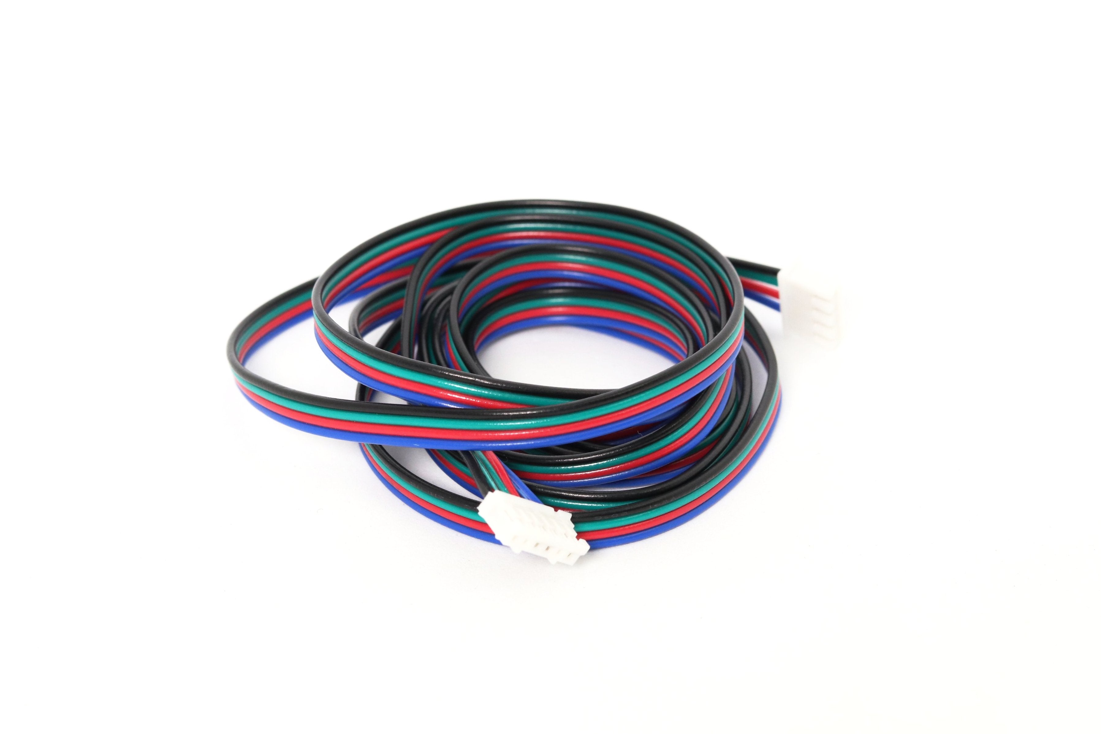

Ribbon cable is usually sold on rolls and as such, you’ll be buying far more than you need, but it will be good for signals and borderline for stepper motors.
On the other hand, this seems like a good deal, given that the connectors are already attached. Trim and re-attach one end as required. Buy extras and use the cable without the connectors for the limit switches.
