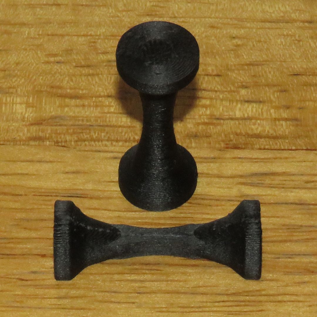

I dried my Nylon filaments overnight at 90C, and retested them… They were stronger (more about that later), but I was still having the occasional coupon breaking through the eye where the pin is… I can’t make that part any bigger, so I redesigned the whole system for new, smaller, faster to print coupons that use half the material…
The vertical coupons are round, using a hyperbolic center and conical ends to anchor them… The horizontal ones are similar, but use the same rectangular test section I did before, at 5mm x 3mm… I made them that way (with a flat bottom) so that I could print them flat without supports… Of course this means I had to design and print fixtures to hold the ends of the coupons…
I printed them from Polymaker PA-612-CF carbon filled Nylon, which has been the strongest material I had tested so far… They are printed horizontal, with support under the thinner tab, where the pin goes through to mount them on my lathe based testing equipment… This is what they look like with a coupon in place…
I have done a lot of testing to insure that the data is consistent with my previous results, and I am delighted with the correlation… All the coupons break in the middle, in the thinnest section as they should… The fixtures don’t flex, and are showing zero distortion or wear… They may as well be machined from aluminum, considering the loads they have to stand, which is no problem…
