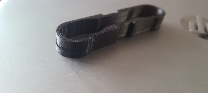

Is there any advantage?
What causes it to shift?
no it wont fit. its the exact same as 1.75mm filament.
also just thinking about it, lose belts on the printer can cause shifts and make prints “sloppy”.

They look as though they are tight enough, it doesn’t droop and has good tension.
Like when checking your fan belt lol
The rest of the print looks good and even. :crazy_face: :crazy_face: :crazy_face:

On your layer shift, it’s either mechanical I think or a slicer error. if your carriages move smoothly with the power off and nothing is loose or being obstructed then maybe try slicing the file again in a different slicer? These are the only things I can think of to cause that.

Everything feels tight and smooth.
That was done with Ultimaker Cura 4.12.1, I’ll find others to try.

look for anything that may have impeded the movement of the carriage in question like a cable getting hooked or it being too close to a wall or something like that. it doesn’t take much for these little motors to skip and that makes them lose their position. you could also try the slice again with the part repositioned on the plate.

Everything looks good, I think it probably was the slicer, it happened once before near
the end of the spool holder. I’ll just keep an eye on it and reprint if need be.

I think I found the shifting problem, I’ll be sure when it doesn’t happen till I take the bed off again lol.
The bed is on springs, I had it off (don’t remember why lol) I think they were just settling, plus through adjusting them.
