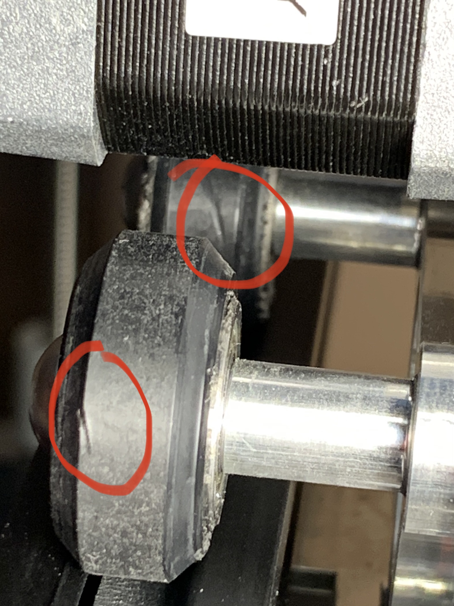

So it’s marginally worse since I adjusted the eccentric nut. But I’m pretty sure I have a damaged wheel as I could definitely feel a bump/drag when I was moving the x axis carriage by hand. Just need to try and figure out which one. Either that or say eff it and replace them all haha.
Well that can’t be good…
Nope that is toast. Sorry moose.
Yes like others have said. I adjust mine as loose as they can be with out allowing the carnage to rock or twist if you would rather, If you have one bad one you should check the others. I decided for the time and cost to just replace them all. Once I was in it just seemed easier and for me the 30$ wasn’t worth the time of putting it all back together and maybe having to take it apart a second time. I just changed them all. (I had 4 bad ones so it was wise in my case)
I’ll just change em all. Not a big deal. Are there different kinds/materials? Are there upgrades that will make them more resilient going forward?
