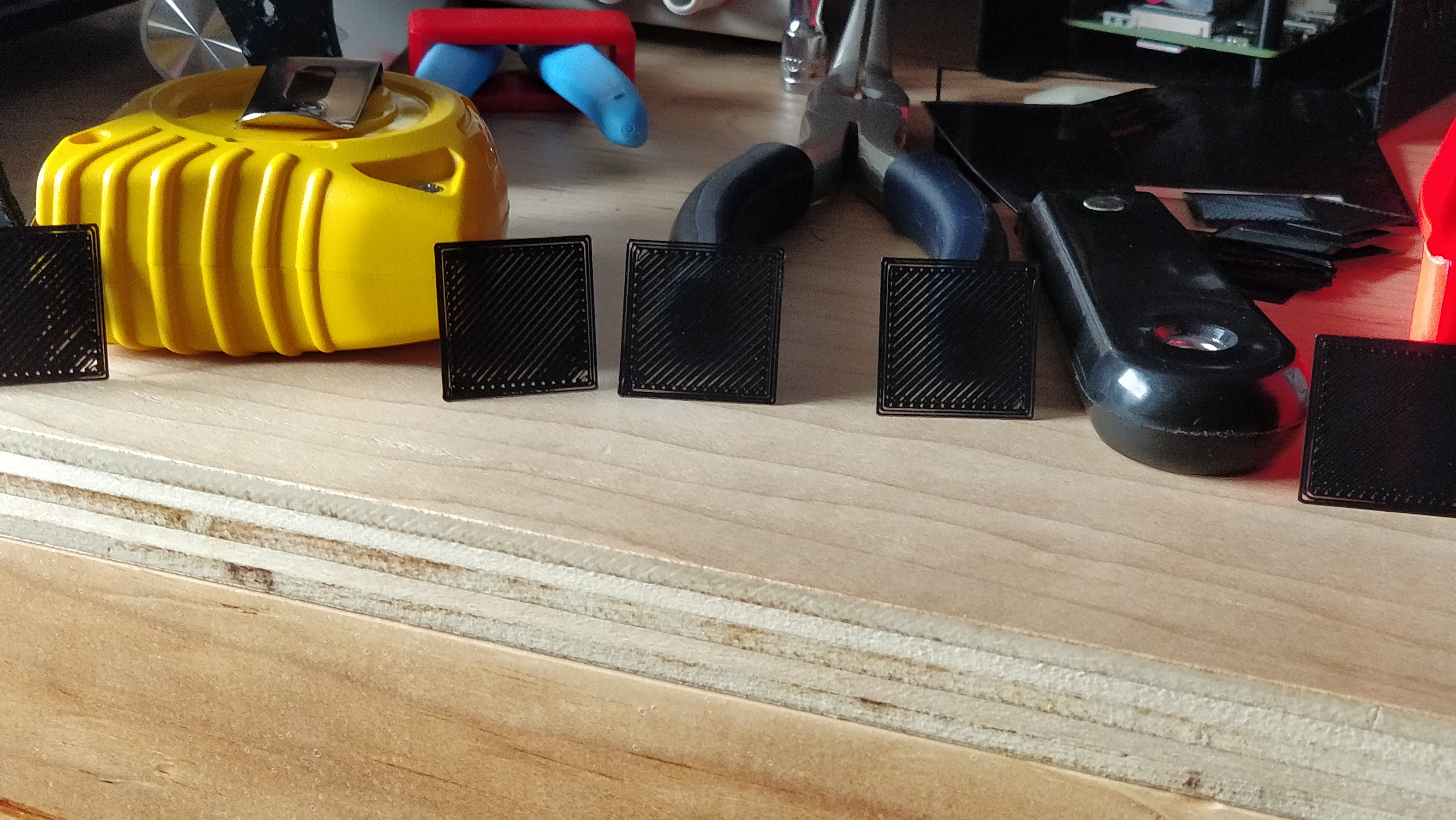

hrm ok. That’s why I try and describe it because you can’t trust the photos. Just game me an idea I think I have some layer tests I printed saved with my black PETG lemme see if I can get a decent pic
Right now my z axis is plus 004.8. Should I auto home and then do baby steps?
well if your tops are smooth then that should be ok then I guess I’d look at adhesion because some of the perimeters look like they were curled away. The shiny black filament is really hard to photograph heh.
Ive taken the pieces off bed and only one I can hold up to the light and not see through. The others you can see through. Just like in video it says its too far?

ahh, so it’s like rungs? The plastic some out of the nozzle round and the distance and travel is supposed to make it squash together so they join. that’s where it gets its strength from so laying o the bed the cross-section is oblong and touching between rows so you should not be able to see through to daylight between them. Yes too far. @TurkeyOnRye has a method for your printer to accomplish baby steps I didn’t realize your printer didn’t have that specifically.
So Ive done a few test prints and adjusting from +4.8 to +4.9 and up to +5. and to me print is pretty smooth but I can still see through all of them when I hold it up?
Smooth is good, sometimes I can see through mine if I hold it to the light, depends on the filament.

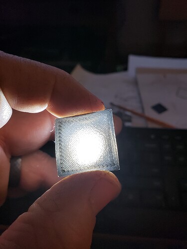

Seeing though like it’s transparent or seeing through like there is nothing there? Thin plastic gets translucent but if the tracks aren’t touching and stuck together then you’ll loose strength. This is one of the above squares with a light behind it.

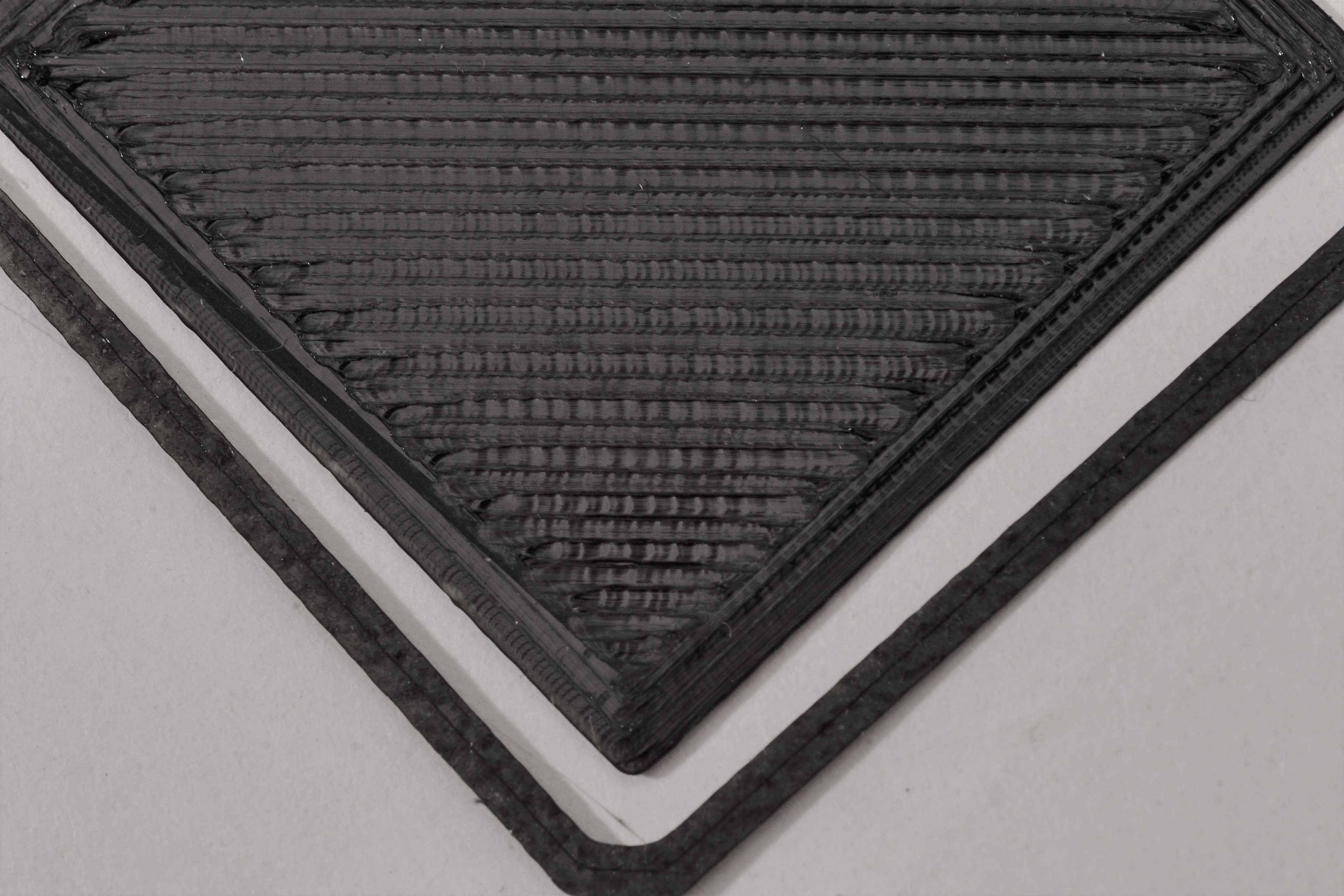

The first photo looks like it’s too close but the last photo with the guitar-looking first layer seems like it’s too far but you said the layers are smooth without ridges. In prusa slicer, the only extrusion width I see is under the print/advanced tab. On and ender 5 the first layer width by default is 0.42mm what is your first layer height setting on this test print?
